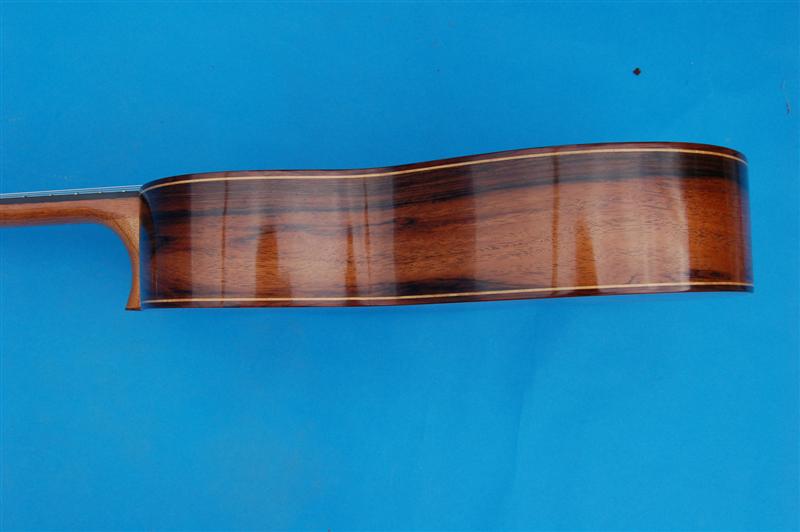

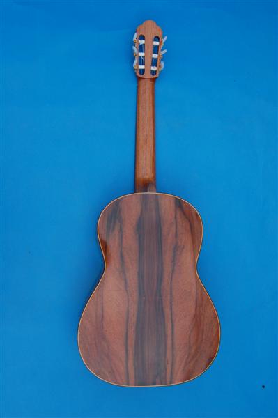

I finally finished the classical I have been working on.
It sound really nice-the finish is still soft so I know it will "open up".
Tried a bunch of new tecniques on this one such as french polishin",hot hide glue,solid lining (willow) on the back and one piece wood rosette.
Specs:
Top-Carp spruce from Steve at Colonial
Back,sides bridge and head veneer-Brazilian rosewood,cut from the same board
neck-Spanish cedar
fretboard-ebony
rosette-pink ivory

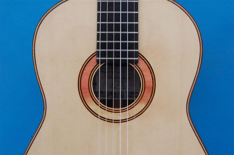

binding-Brazilian rosewood and Ceylon satinwood

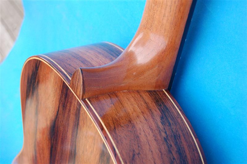

Wow, That looks great!  I love the wood.  I just finished french polishing my first and it looks pretty good but yours looks flawless.  Did you have any trouble with where the neck meets the sides?
Also, what kind of grain filler did you use and what did you do for the final buffing?

Brad, that is one beautiful instrument. I really like the rosette. Nice chuck of zoot to produce all that. I also find it neat that one sponsor utilizes another.

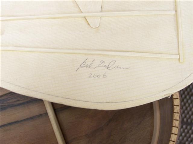

Brad, that is a knockout classical.  That is some gorgeous BRW. I'll ask too, what is the bracing style that you used, size etc.?

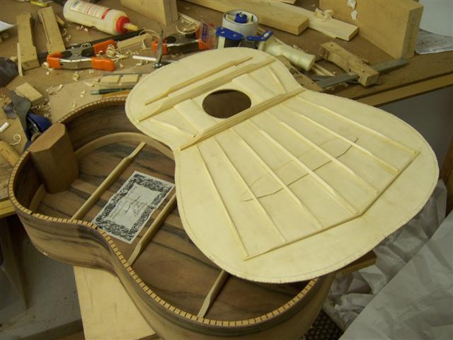

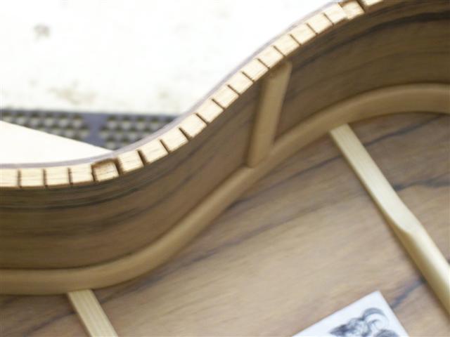

Very nice Brad! Do you have any inside pictures you can share with us?

Clint, I did have a little trouble french polishing where the neck meets the sides,but it did work out after many sessions. I used a water based pore filler and I also used the pumice method. It hardly needed any buffing at the end,I used the fine Menernza compound on the wheel VERY lightly.

It is a simple 7 strut fan bracing pattern.
Ed,
here are some photos of the innards:

Very nice Brad. The BRW bindings were the right choice as the satinwood line becomes the major design element.
The Pink Ivory rosette is a knockout. With the fade from the pink heartwood to the sapwood it looks like a sunrise.

That rosette is awesome.

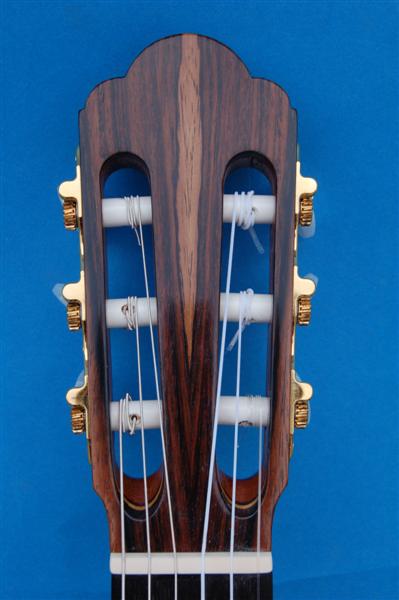

Great looking guitar Brad. I particularly like the work and shape on the peghead.
